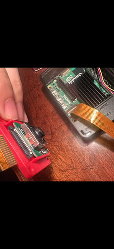

This is the way I connect it to the arducam.

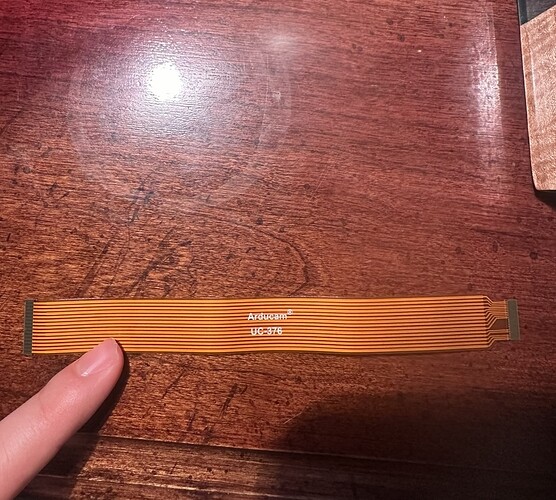

Do you really think it could be the cables? If you do, can you send me an Amazon link to the one(s) you use? I didn’t think the brand would make a difference.

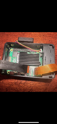

This is the way I connected it to the pi:
https://www.kiwi-electronics.com/en/raspberry-pi-camera-cable-standard-mini-500mm-11590
this is the text my camera cable has on but 500 instead of 200

Besides, I’m worried about the camera you are using is not compatible with this camera module.The cable as @henri mentioned is practical. Can you get one or do you have the 22-15 pin cable from Arducam like the one below?

  4. Here’s another cable I have. I got it when I purchased a set of standard 15 pin cables which happened to come with this single arducam 15 to 22 pin cable. Please let me know if this would work:
If not, do you have an Amazon link, or ribbon cable model name I should specifically look for from Amazon? I want to take advantage of their fast delivery lol.

the ribbon cable was connected properly on your images

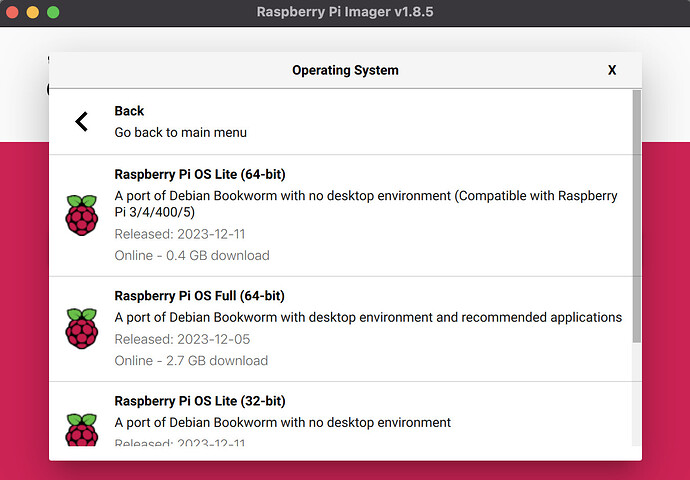

Is it the 64-bit Lite version or the 32-bit Lite version?
and would you mind writing the revised bash code for the installs? I don’t want to mess it up.
64-bit. and i usually enable ssh in the rpi-imager settings and set login username password and also hostname

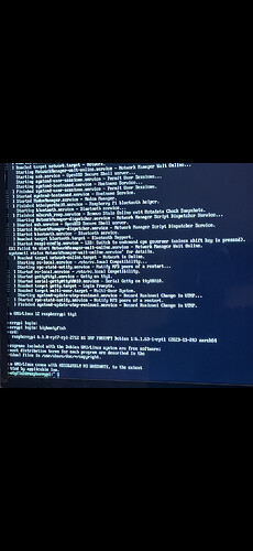

This is my first time using an OS without a desktop environment. The screen is supposed to look like this right? It’s hideous. If I follow your steps using this, how will I ever get a preview of the camera if it does work?

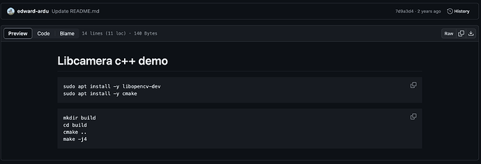

Is this edwards example you meant?
Sorry for the incompetency, I hope you’re not disuaded to help, but much of this is new to me. The entire GitHub is in C++ and C, and I’m still a beginner at those languages. i was hoping for a guide for bash commands. At the moment, I’m still trying to learn how to record a 10 second video, but chatgpt keeps giving me incorrect commands.

the link i posted is my fork from edwards c++ camera demo its the simplest example that i found to understand how libcamera API works. edwards code does not compile anymore with latest libcamera since the transform parameter was replace with rotation parameter, but mine compiles since i updated it.
