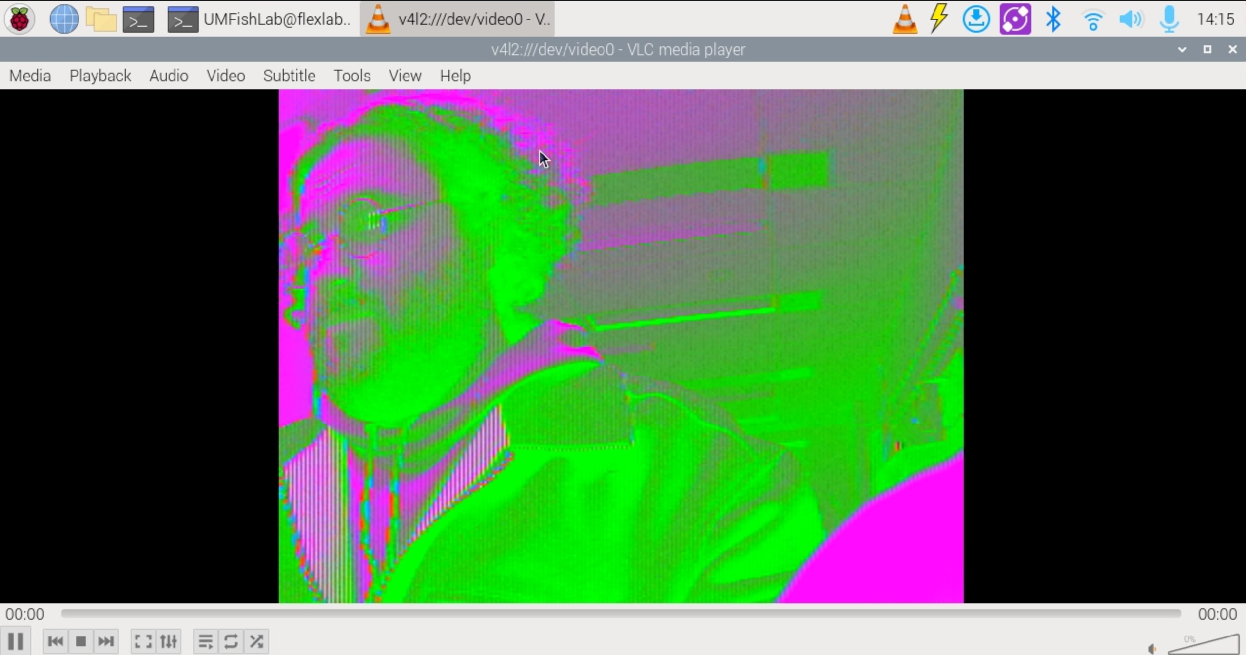

Hi all, having a weird issue with my new Arducam IMX462 USB camera on a Raspberry Pi. When I open the video feed in VLC, the entire picture is pink and green — totally corrupted colors. I’ve followed the UVC-Camera setup guide on the Arducam site but no luck.
I also tried looking for qv4l2 (or was it qv412? I saw it mentioned somewhere) but it seems like it’s not available to download anymore. Is there a compatibility problem between this camera and the Pi? Anyone else seen this pink/green mess in VLC?
Here’s what it looks like:
Camera is the Arducam 2MP IMX462 Day and IR Night Vision USB Camera with Metal Case.
That pink/green output is a known VLC compatibility issue with the IMX462 UVC camera — you’re not doing anything wrong. VLC’s rendering pipeline doesn’t play nicely with the raw video format these cameras output over UVC, hence the color corruption.
The tool you’re thinking of is qv4l2 (Video4Linux2 Test Utility), not qv412. It’s still very much available — you just need to install it from the apt repo. Try this:

Then launch qv4l2 and select your camera device. It handles these UVC streams properly where VLC falls over. I’d recommend using qv4l2 as your primary viewer/recording tool for this camera on the Pi rather than VLC.
That did the trick — sudo apt update && sudo apt install qv4l2 and the video is crystal clear now. Thanks!
