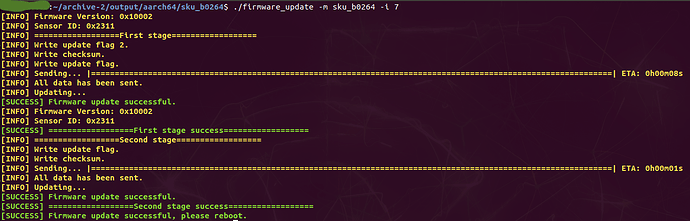

Thanks, Dion. For the camera that I had the “bad” firmware update on, the latest updater you sent still results in x10002 as the reported firmware version. I’m attaching some screenshots below to show the history in case it is helpful in further troubleshooting. I’ve included results on a second B0264 unit for comparison.

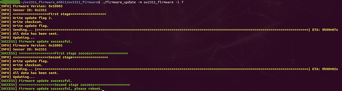

Camera A: This is the original “bad” firmware update that I mistakenly installed based on guidance in this link: Install_pivariety_pkgs.sh update and FAQ - #64 by Edward. You can see that the version went from x10003 to x10002 during this update. The camera was rendered non-functional by this update.

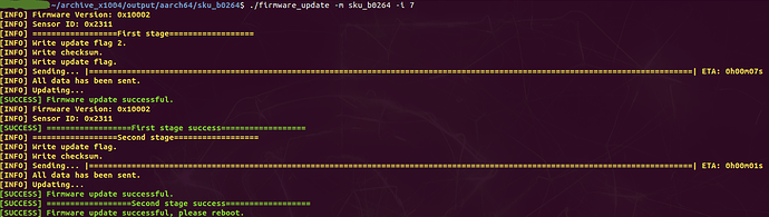

I then applied the first firmware update that you shared on April 1st. The firmware version didn’t change and remains at x10002:
I then applied the firmware update you shared on April 2nd. The firmware version didn’t change and remains at x10002. The camera is still non-functional:

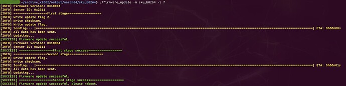

I took a fresh b0264 unit, which I’ll call CameraB, and applied the April 1st firmware update to it. The version changes from 0x10003 to 0x10004. Based on the instructions you sent, I believe this was the expected outcome. The camera is still functional after this update.

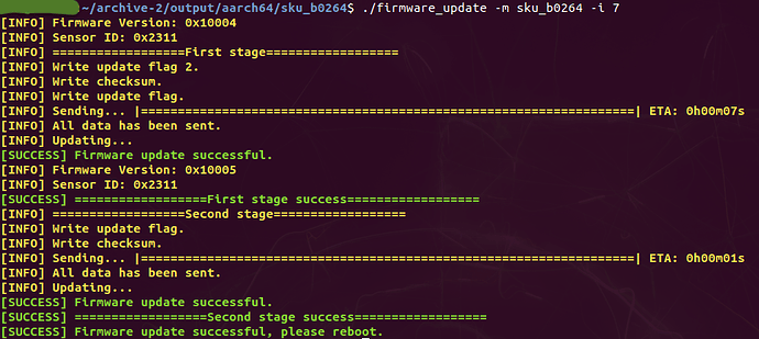

I then took CameraB and applied the April 2nd firmware update you sent to it. The version went from 0x10004 to 0x10005. The camera is still functional after this update.
