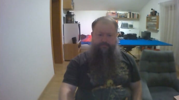

I’m having a trouble getting good picture out of the IMX708. Tried both Arducam B0482 and Raspberry Pi Module V3-12MP IMX708. Both produces the same results.

gst-launch-1.0 -v nvarguscamerasrc sensor_id=0 aelock=false awblock=false wbmode=0 exposuretimerange=“50000 30000000” gainrange=“1 8” ! ‘video/x-raw(memory:NVMM),width=2304,height=1296,framerate=55/1,format=NV12,colorimetry=bt709,range=full’ ! queue ! nvegltransform ! nveglglessink -e sync=false
The same camera works fine on the Raspberry Pi. So the question is should it even work Jetson Orin Nano?

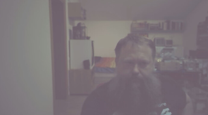

Hi @Dion so I got my hands on Arducam B0392. I fixed the red tint. I removed the glue to allow for focusing. This is what I get:
Can you please suggest me a camera that is wide angle and that produced focused color image that I can process on Nvidia Orin Nano? I remember in the early 00s webcams were terrible, but I still think that they produced better image then I can get now with these Arducams in 2025 on expensive Nvidia hardware. I’d very much be thankful if my next purchase of cameras (yes, I order couple in a hope that they would work) would actually work decently.
