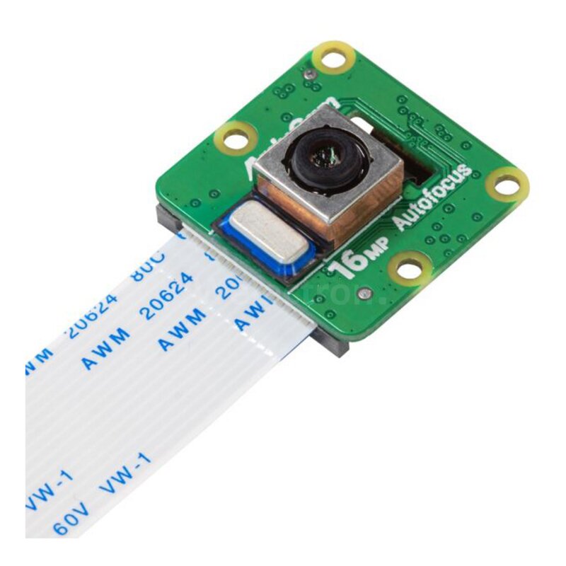

i have got a Jetson Nano 2GB,
R32 (release), REVISION: 7.6, GCID: 38171779, BOARD: t210ref, EABI: aarch64, DATE: Tue Nov 5 07:46:14 UTC 2024
i bought this camera:
i used this guide:
