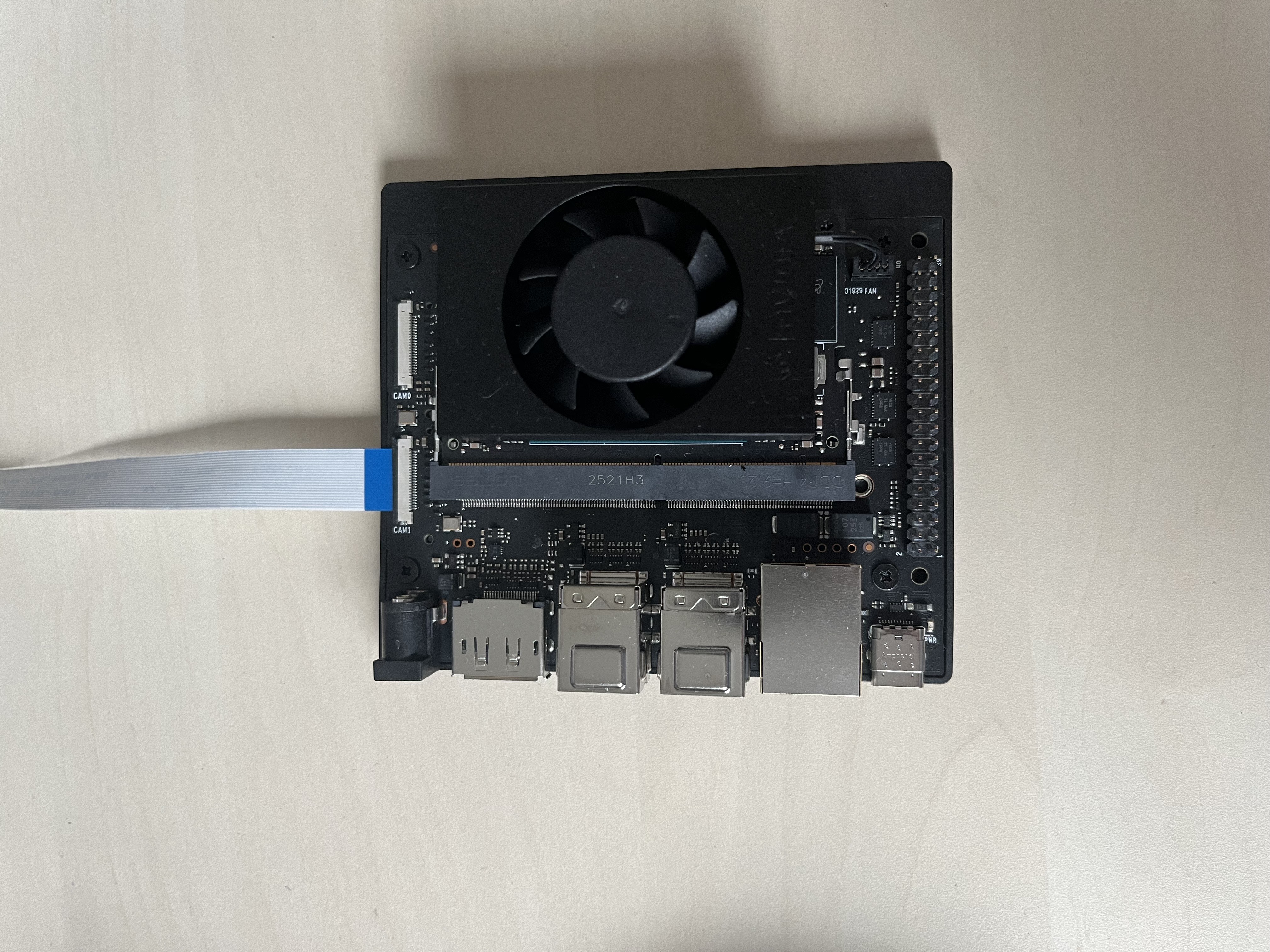

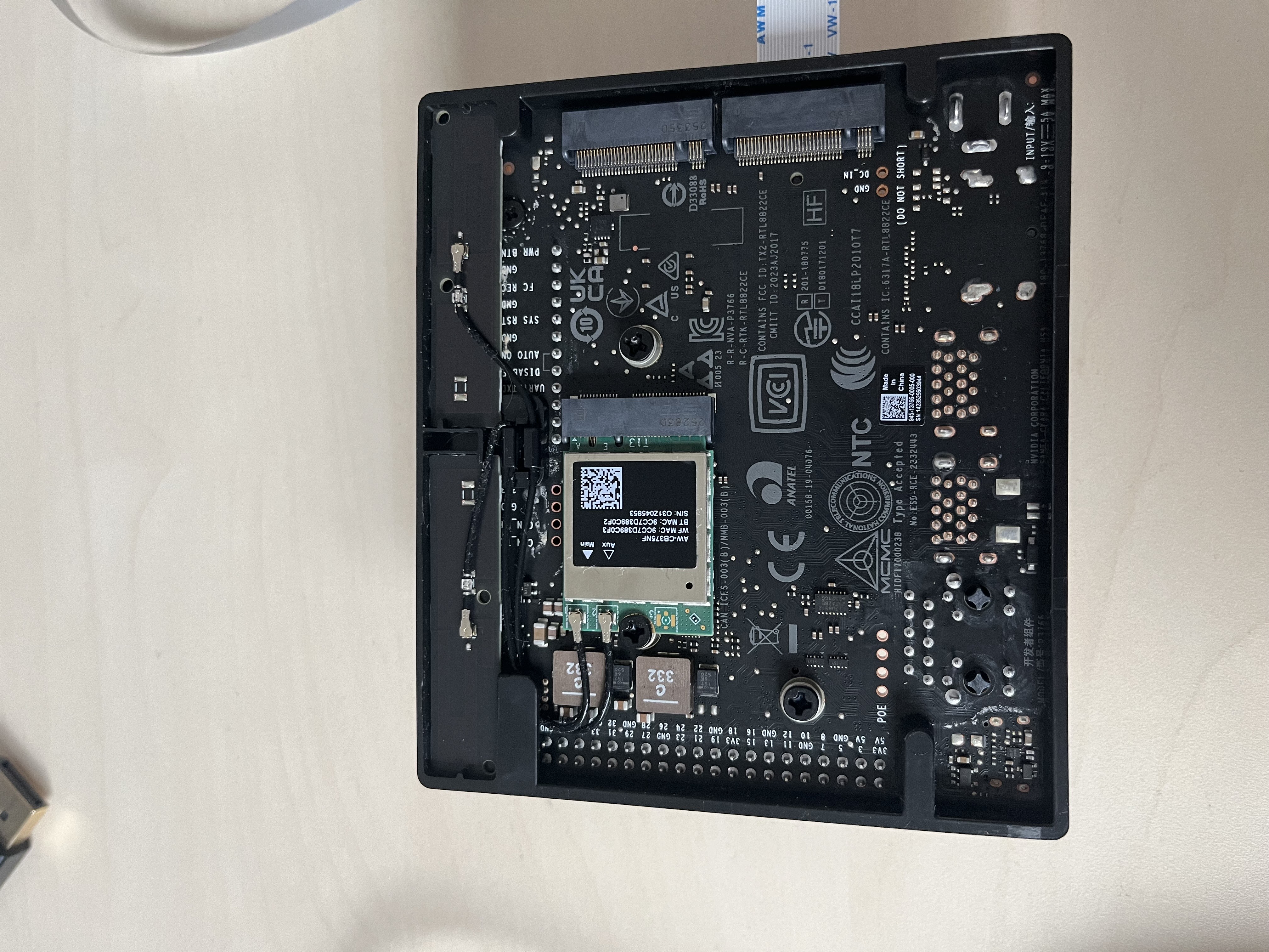

To help narrow things down further, could you post a couple of photos of your Jetson Orin device — front and back? That’ll help confirm the exact hardware configuration before we go further with troubleshooting.
Sure, here are the photos of the board:
Front:
Back:
