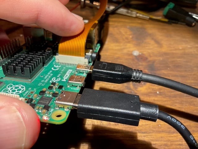

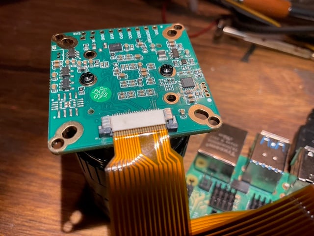

  1. Post clear photos of the ribbon cable connections — both at the camera board end and at the Raspberry Pi CSI port end. Sometimes a slightly crooked insertion or a cable oriented the wrong way can cause this.

Cable photos:
Camera board end
Raspberry Pi end

  • A physical ribbon cable issue (even though it looks seated correctly in the photos, a damaged cable or a slightly misaligned contact can cause this)
