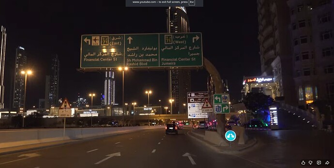

I just have one more question. Would this particular camera be clear enough at night time with streetlights to see like this:
If not the case then can you suggest a similar camera with a similar price that can be this clear during nighttime with street lights?
I haven’t actually tried that myself, so I can’t say for sure.
Your best bet is to check with our sales team at [email protected] - they can let you know if it’s doable, otherwise, suggest a suitable camera.
