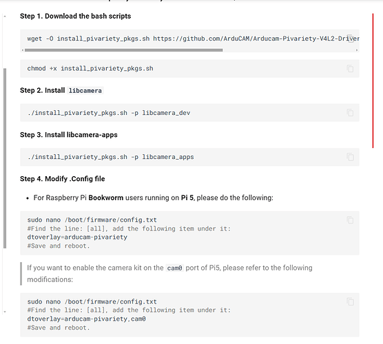

Hi guy any idea what is the issue. Does the arducam IMX462 work on last release of Bookworm, because your installation script still point to /boot/config.txt which is not used anymore by the OS, it is now /boot/firmware/config.txt
Dion
May 11, 2024, 2:56am
7
Hi,
It seems that you did not follow the correct guide before. Please follow the steps below to configure your Raspberry Pi to access this camera module.
https://docs.arducam.com/Raspberry-Pi-Camera/Pivariety-Camera/Quick-Start-Guide/#pivariety-cameras
It works, thanks for your help.
