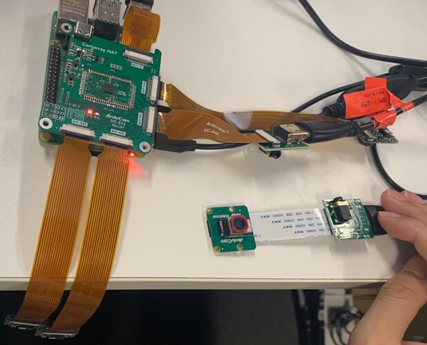

Response received from Dion via Discord:
CSI-to-HDMI extenstion kit doesn’t work solidly with the HAT board this way. I used to try connecting the cameras to the HAT RX ports with B0091(HDMI extension kit). Some 1m HDMI cables can make it(like from Ugreen), but most of cables I tested cannot. I don’t suggest customers take this solution at risk cause it might turn out to be time waste or money waste, or both…
