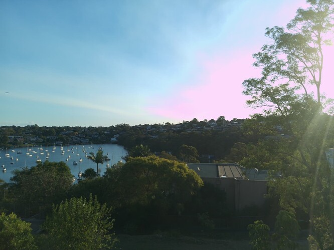

Specifically with 64MP images and the OV64A0 camera module, I am seeing a very large number of pink images. This is across multiple sensors and multiple RPi5s.
Is there a way we can have a better default calibration in the libcamera repo?
Or ways to improve / avoid the AWB turning the sky pink?

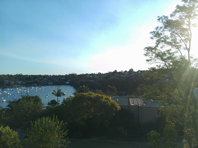

I managed to figure this one out last week.
The issue is the calibration inside the libcamera stack is wrong.
I had to turn off the auto gain parameter and then the pink images stopped occurring.
Using --analoggain 1.0 makes the pink go away.
I also added a custom calibration file with lower red gain. The one in the library does not appear to be very good.
