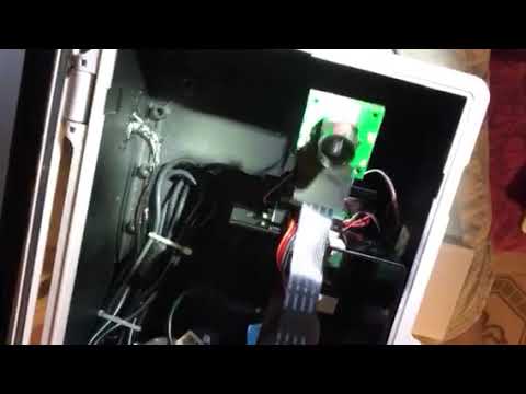

Q: If I touch the camera platform one of the servos starts vibrating, touching again it vibrates a bit less or it stops. No software is running.
A: try to set up the value of the rotation angle from 0-180°to 10°-170°? Because 0-180° is its critical value, which may be unstable.
Q: The issue also happens when no software is running to manage the servos.
Remember this video IMG 7908 - YouTube I only touched the structure with my finger.
I replaced that circle by a camera with its lens as you can see in the last attached video.

When I change the position of the camera with that script it works okay but sometimes the kit starts shaking as you can see here. Sometimes it stops by itself, sometimes doesn’t.
