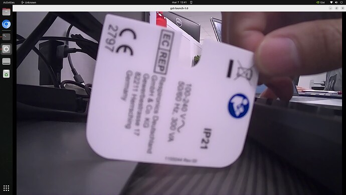

I have the ArduCAM IMX519 B0449 connected to a Jetson Orin Nano (8GB ram), I need to know if it is possible to focus with this camera, the drivers do not show me something similar, do I need another driver or this model does not support it?

Is it possible to focus in on this label to display the text clearly with the ArcuCAM IMX519 B0449?

Hi,
You can twist the lens for a better focus effect. If you have any trouble twisting the lens, you need to use a heat gun or hair dryer to melt the adhesive around the Lens.
