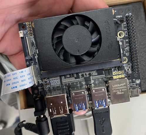

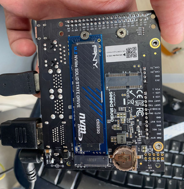

Before I go further down the driver compatibility rabbit hole, could you post some photos of your Jetson board — both front and back? I want to verify the exact hardware platform we’re dealing with here. Sometimes what people have doesn’t quite match what they think they have, and that can cause all sorts of problems with these camera drivers.
Sure, here are photos of my Jetson device:
Front:
front
Back:
back
Let me know if you spot anything.
Thanks for the photos — and I think I’ve found the problem.
Here’s the thing: what you’re using is a third-party carrier board, not an NVIDIA official Jetson Xavier NX Developer Kit carrier board. Looking at the board layout, the CSI connector routing, and the overall PCB design, this isn’t the reference design from NVIDIA.
I’ve marked up what I’m seeing:
board comparison
board comparison
This is the root cause of your issue. The Arducam camera drivers and the MIPI_Camera install scripts are developed and tested specifically against NVIDIA’s official development kit carrier boards. Third-party boards often use different CSI pin mappings, different I2C bus assignments, different power delivery for the camera connector, or different device tree configurations — any of which can prevent the camera from being detected.
There’s no amount of driver fiddling that will fix this if the hardware-level CSI/I2C paths don’t match what the driver expects. That’s why it works fine on your Raspberry Pi (standardized CSI pinout there) but is completely invisible on this board.
Your path forward is to get hold of an NVIDIA official Jetson Xavier NX Developer Kit carrier board. Once you have that, the driver installation should work as expected:
