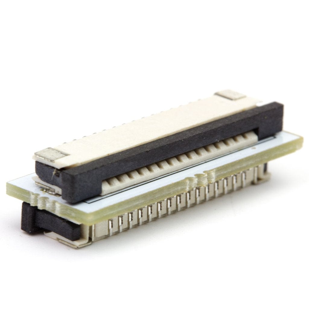

I have a pi 5 now and I’m trying to connect the Arducam imx477 but we need ribbons which have small connectors at both ends.
Would this work by using an adaptor like this:
…and then using two of the pi new 5 camera cables?

Hi, is there any indication if this combination of ribbons and joiner would work with the Pi 5 and the IR cut HQ camera?
Hi,
Our imx477 camera modules are using 22 pin interface, and the Pi 5 is also using the 22 pin CSI interface. Please check the link below:
oh thanks, I’ll try that :slight_smile:
ok I have it working with a 22 pin ribbon cable and Pi 5 :slight_smile:
