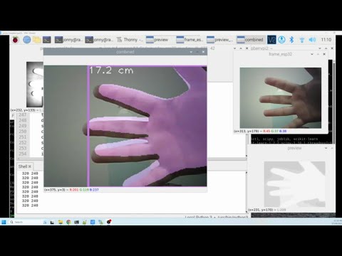

Hi,
One of our customers has a project similar as yours, may be you can refer to his idea.
